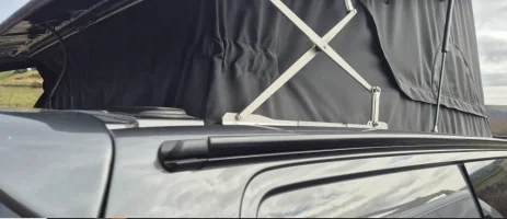

Most people fit a multi-rail as it normally serves two purposes.
The first purpose is that it has a c-channel in it so you can attach the awnings and canopies by just sliding them into the channel. (Or a driveway kit that comes with a figure 8 channel and a section of double 6mm beaded kador strip)
The second purpose is that it acts as a rain gutter to stop any rain leaking down when you've got the all-in above or canopy about attached it redirects the rain to the front or back of the van. (So it doesn't drip down when you're coming in and out of the side slider when you have a canopy attached)
So for people that already have a multi-rail installed, fiama have brackets made that enable you to adapt and wind out all in to a van that already has a multi-rail.
It should also be noted that most wind out the armia have a c channel built into the front lip of the wind out section, as some of our guys attach the wind out all in to the front of the wind out section.
