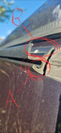

Does anyone know what B is used for. A is obviously an awning attachment but not sure what the upper bit is for
Channel A is for the 6mm kaydore strip on your awning.
Channel b at the top is a rain gutter and can also be used for hooking things onto and some older style awnings that have round bars that camping.
Looks like you are missing the rubber band that goes at the end and a row as well.
Have a search for the vanmoise multirail end cap.
I wondered what that block of rubber at the end was for or what had been attached to it. Makes sense now.
