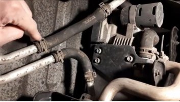

This is not mine, but shows the two pipes which run to the rear hvac, these were disconnected and the two flexis joined with 15mm copper. Will get mine on ramps and drop the cover to get a pic tomorrow
