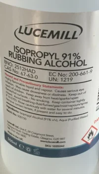

Before doing this though it says I should clean the panel with rubbing Alcohol of something similar. I have this, but I am unsure if I should use it on my van.

I used IPA before applying mine, free from work 😉
It cleans a treat and doesn't damage any paint.

Your rubbing alcohol (IPA) is perfect for cleaning the area first. Use a solution of 1L water with a drop or two of baby shampoo (the yellow Johnson stuff) in a clean spray bottle to apply the decal. Spray the area, your hands and the decal and peel of the backing then spray that side too. Keep everything wet with the solution. Apply the decal and use a squeegee to remove the solution working from the centre out. Any bubbles can be pricked with a needle and water removed. Leave to adhere for about 24hrs.
