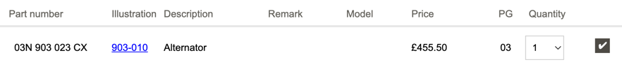

Hi All . About to change pulley and alternator as the alternator overrun is failing. After looking for replacement I’ve noticed a 180 amp version. Presently a 140 amp. Is it worth upgrading as I am also going to upgrade to a 220amp lithium leasure battery as just not enough power off grid . Also will it bolt straight on or is a modification . Thanks
The California comes with a 180A so if it's available you could, but it won't be cheap.
