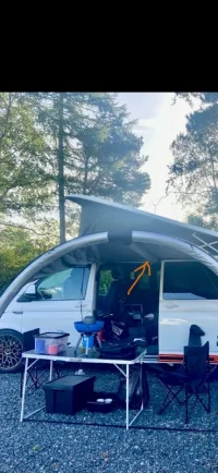

Air Awning repair stitches & steel
It’s says this would do the job I think but I can’t quite work it out from the photos
The only problem with the using a kador strip and figure 8 is that the latter usually comes in 3 or 4 sections and they inevitably leak through the gaps. My solution was to source one long length of it but you might then have storage issues for it (which I resolved but we then just decided not to bother with it and just go straight into the reimo rail).

Ideally to shorten the tube you need it RF welded, anything else won’t last very long or at all
