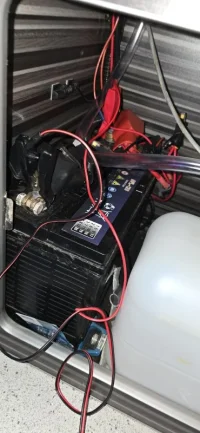

Last Sunday, my parents came round, they've not properly seen my camper. I was still jetlagged from my 10 hour flight from Mexico, as they picked me up from the airport. Maybe I got too excited and carried away, but it appears I've left the 12v system on!

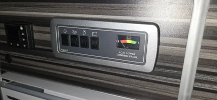

Just got back from a meal out and went to put the lights on in the back, nothing! Looked up and seen the system on and battery meter dead.
The Ctek hasn't been able to charge it, as its been left on.
Immediately, I've got the EHU out and plugged the van in, I then plugged my old but hardly used trickle charger in, but this too Is not recognising the battery connected. I believe under 7.5v the battery charger don't work. In fairness, i think this charger isn't up to the job.
I've left it on trickle charge, but I fear the worse.

You’ll likely to be able to tease the battery to life again but it might have suffered and hold a lesser capacity.
Try a recovery mode if your charger has one - for example Victron chargers have this:

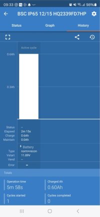

Thank you. I'm gonna order that charger now on amazon, it's already in my basket

I had a dead lead battery and bought the same Victron charger… don’t expect magic from the recovery function! I got just a handful of Ah capacity from the battery even after using recovery for a number of days.
If the battery is already toast the Victron won’t be able to turn it back to bread!
