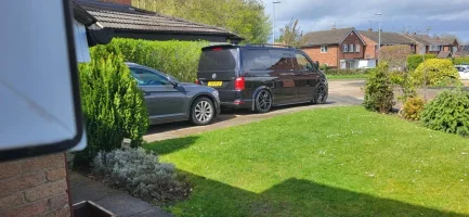

Got any photos of yours? I'm on solows. Van was wound fully down with locking ring removed for extra lows when I got it. Had to raise it abit as couldn't get on my drive or local speedbumps!
This is mine. Not quite fully down About 130mm drop with adjuster deletes. Sorry bout the photo. Just hung out the window and took it.1000013458.webp
