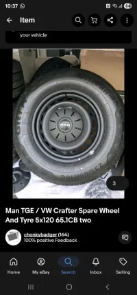

Will vw crafter wheels fit my vw transporter t6
In terms of the bolt pattern, it's a match for a T6.
In terms of wheel diameter, it'll fit, provided your van doesn't have a 17" chassis (in which case, it's too small)
In terms of the tyre size, you can use willtheyfit.com to compare it with your current tyres.
In terms of offset (ET), I'm not sure - someone with a Crafter might be able to help.
