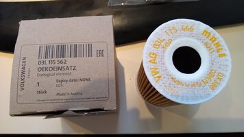

The OEM filter is VW part number 03L 115 562.
The Bosch number is P7023.
These two 2 filters look identical except for their part numbers.
Here are some photos:
