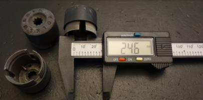

Sounds like one of those measurements aren’t 19mm! I had 19mm standard bolts, and the 19mm standard VW caps fitted perfectly.
if you have some digital callipers, it’s worth checking the dimensions of both.
Post a few pics.
And some tape measure ments...
fwiw . . . swapped my sportline wheels today . . .
so have these to hand . . .
