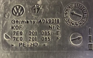

Where will I find the part number? Maybe I can crawl underneath and take a photo of it.
