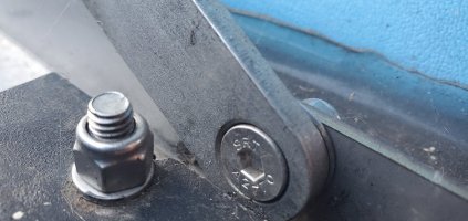

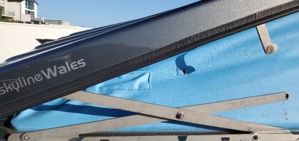

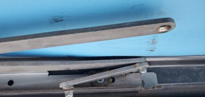

Does anyone know what size bolts and plastic spacer I need for for Skyline Aurora pop top scissor hinge?
One of them has sheared off. See pics attached.
I'm assuming it needs to be high tensile.
Thanks for any advice.

Have a good look at the other side and measure the bolts on that.
I’d imagine that the bolts are just long enough to go through both bits of metal.
They are countersunk Allen headed bolts. Also just looks like a washer has been used as a spacer.
Checking the other side would confirm this also.
I bought these - M6 x 35 worked on my Skyline, long enough to trim to fit.

Thanks for the advice. I went for the 30mm size bolt and hacksawed a bit off after I had screwed it in. All good now.
I managed to line the holes up with the roof partially opened.
Thanks again all.
