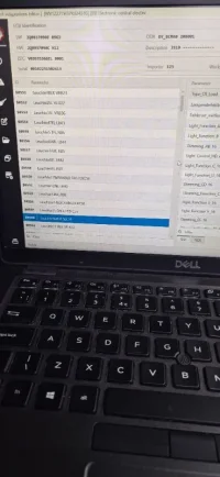

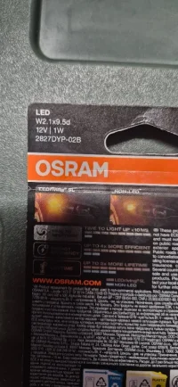

With what? Can't tell from the pics.I went through all the LED settings
With vctool. Should of said. ApologiesWith what? Can't tell from the pics.
Hi, for some reason the pics have come out blurry. Not sure why.
Ok 09
Leuchte 16 17
Lamp load settings value new
Led tagfahrlichtmodul versorgung.
Was the only value that kept everything happy. Tried all the 'LED' title ones to no avail.
I kept the dimming for AB at 100.
Seems very bright already. Maximum brightness for led bulbs is 127.
Now this is what I changed it to.
You do this at your own risk
