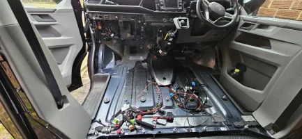

My first post: decided to bite the bullet and fit my subwoofer under the drivers seat. 0800 start, 1600 finish. All done and pleased with the results. As I progressed i was thinking what am I doing as more and more it looked like a shed... 1000021034.jpg

That’s on my list too! Are you sound deadening cab while you’ve got it all apart?
Don't say that, I just put it back together. To be fair I upgraded the mids and tweeters about a month ago and did line the door skins and door regulator inserts with sound deadening. I also fitted that eggbox foam to the door cards. Tap on the door panels and it's a thud. I didn't put any on the floor, I think the thick foam backed floor covering should be OK. If I keep the load area bulkhead then I suppose I could deaden that but then would need to cover it after.

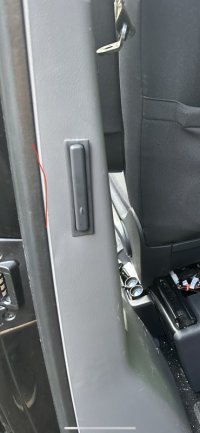

Inspired by many others before fitted this.
It is test fit pending black B pillars and good job as well it needs to go a few mm to the right as I’ve a shuttle with factory door cards and it just catches.
Hi @archersam
i have a shuttle it would be really appreciated if you could give me an idea of the measurements I would need to mark before cutting as I haven’t got a spare trim and knowing my luck I would just dive in cutting and make a mess of it
Hi @archersam
Ok so from the “line” mine is 23mm.
Vertical location will be obvious - there are two lugs that hold it the van so you want it in the middle of those but plenty of wiggle room
Mine has a bunch of cables running down the pillar and so I found best way was to slide it between the two sets as otherwise they put too much pressure on it and it bent a bit.
IMG_1742.jpegmiddle.
Now you've had it apart once, doing it again takes no time - trust me :think smile bounce::slow rofl:
I have the foam backed carpet in my shuttle however I still went ahead and did it as made sense to do so.
