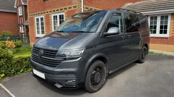

Yes, I appreciate there are plenty of differing views on this topic and it differs with the amount of drop. I have previously had the no load set up and ended up having two blow outs on the rear and went through a few tyres... I will keep a close eye on tyre wear over the next few months. 500 mile round trip next week, so will get chance to give it a good check over. Loving the drive at the moment though... :cool:
What gap you got now? Will need do that at and see Steve at some point after new wheels and gap it’s a bit small but no rubbing at moment
Had it lifted up from 55 drop to 30 drop overall with different springs and adjusters... Sounds like you need similar, maybe a touch more if you are on 245/65 BFGs... Mine are 235/65 Wildpeaks. I'll measure and post picture tomorrow if it helps. šŸ‘

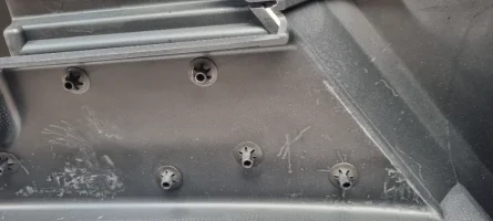

Now the bench has gone I fitted the replacement seat adjuster to the passenger Captains seat. ( the original was a bodge welded job at an angle and never worked ) Now the locking pins work!
Also fitted both Vanshades and the Vanshades door storage to sliding door.
I really like the fly screen in combination with the Safari window
Now both lower sides are carpeted I can work on the roof area and also the lower ply panels
( Milan fabric due from Harrison's anytime )

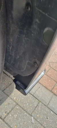

Fitted the front end up, ready for paint yesterday. For anyone fitting a leighton bumper, instead of plastic welding the 58 tabs use 6mm star wahers and cable tie grips, its alot easier and if you need to remove them its fairly easy. Aslo made a fill in panels where the shit liners don't meet to the bumper.
