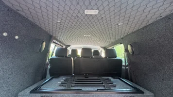

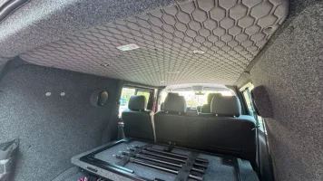

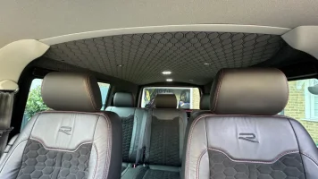

Nice...Not done today. But over the last few days.
Retrimmed B Pillars installed.
Front seat base "back boards" installed
Autherm air heater Comfort Controller moved to dashboard area.

You made them?
I repurposed the oem trims, by grinding the wording down, filling then painting. Then sourced some badges that actually fits. That was the hardest bit. After putting this up I re-did them because I realised the spacing was wrong.You made them?
Wow dedication. Nice jobI repurposed the oem trims, by grinding the wording down, filling then painting. Then sourced some badges that actually fits. That was the hardest bit. After putting this up I re-did them because I realised the spacing was wrong.
