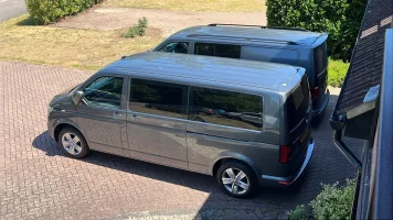

Just ordered a pair of rear windows (Transporter HQ) for the current conversion. Will try to get them fitted this week before a group riding weekend in the Lake District this coming weekend.
NOT MY VAN
