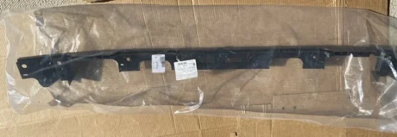

Had my Towbar fitted today, I bought all the additional parts but was told by the fitter I didn’t need them as they are already on the van, the dealer won’t take them back and give a refund because they were ordered in, so if anyone wants the plastic rail, all the clips and the 2 foam pads, come and collect them from me for £30
That is cheap as the foam pads are nearly £25 on there own. Guess you had a kombi shuttle or caravelle or a van with towbar prep.

Happy to take pictures of what I have, not possible until tomorrow evening though.
Apologies for delay, currently this is all I can find, will check the westfaliia instructions to see what else there should be, possible been used.
Haven’t been able to find anything other than the that, the other items on the Westphalia instructions I definitely had so they were either used or I’ve subsequently lost them. It was over a year ago so could have been either, as mine a factory Kombi didn’t have the foam.

If you have a T6 panel van, the above part is required and replaces the existing van crash beam, vans with windows behind the driver i.e caravelles, Kombis, Shuttles etc already have this part in place, in addition to this two foam pads are required to support the bumper. (Part no. 7H0807252A)
