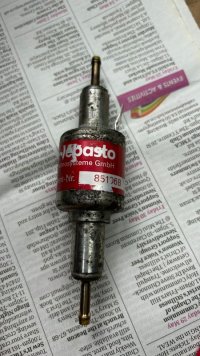

Hi all. I have a Webasto fitted (I think it's about 10 - 15 years old) on my T5.1 - was working fine last summer but failed to start in the winter. Finally got round to attempting to sort this with my son (underneath!) as my mechanic could not help - as a fuel issue was suspected b y Butler Technik we have removed the pump to test via a direct connection to 12v and it seems to have failed as making no noise bar a faint hum and not test-pumping. Is it worth trying a cheap eBay-Amazon special pump to see it if fixes the heater before going for an OEM pump?

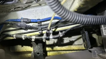

Original installer has also T'd into the engine fuel feed which I understand is not ideal.

Errrr...... The pump does not work like that. If you are lucky you may have got away with not burning the pump out doing that! The pumps work on pulses from the ecu.

Have you got a coolant heater fitted also - looks like it. If so you can tee into the fuel line for that heater which I suspect yours is.

I have read a long older topic with your very useful input on fuel line installation - the correct way by dropping the tank and a stand pipe into the sender unit - and when people have teed into the feed to the engine fuel pump that this is not a good idea for various reasons. TBH in all likelihood I will install a new heater for many reasons but are you saying however, it is OK to tee into the diesel line to the factory auxiliary engine heater?
EDIT: looking at the pic I'm guessing (my son was under) the VW engine heater is on the extreme right with part of a Webasto label - so that is indeed the feed into that they have teed into? And there are none of the downsides doing this compared to teeing into the engine fuel supply?
