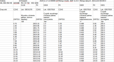

Picture 1: There is no fuel pressure (IDE07818 = 0...1 bar) even though ECU asks for 320 bars (IDE07820) - assuming the snippet was made while cranking the engine.

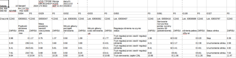

Picture 3: The engine is cranked quite well (IDE00021 = 236...254 RPM) but the injectors do not fire (IDE00352 = remains at 0 µs) - obviously because there is no fuel pressure (IDE00589 = 0 kPa)

Hmmm... while cranking the lift pump in fuel tank (IDE07824 on the logs) creates some pressure (a few bars) to make fuel flow...

Those logs are showing a requested pressure of 200bar to 320bar, and an actual pressure of 0 to 1 bar, so as good as zero. As said above, the 1 bar is probably the lift pump.
So, it looks like there is a fuel supply issue, the new pump has packed up, or the pressure sensor is faulty.
