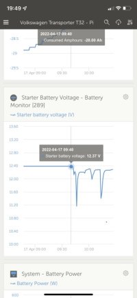

I've not been driving the vehicle and so the starter battery hadn't received any juice over the last couple of weeks or so. The voltage fell pretty low yesterday, so I got my wife to take me for a day out to recover a volt or so.
This morning I noted that when I unlock the van, my battery monitor shows that there is a drop in voltage for a few minutes, indicating a load on the starter battery. This load doesn't last long.
The regular locking and unlocking without driving has been slowly draining my starter battery, but I don't know why.
The load which I refer to isn't the unfolding of mirrors, interior lights or show me home lighting, so I assume it must be fuel pump or some other preparatory function that VW seem necessary.
I will charge the battery when I get a chance, but is there a clever way of avoiding this load on the starter battery at the time of unlocking?

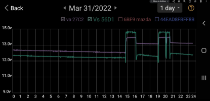

Here is the monitor showing good voltage of 12.37V and then you can clearly see the voltage dip for 3-4 minutes when unlocked at 9:40 this morning.
When you unlock the van all the modules power up in preparation for an engine start.

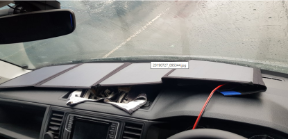

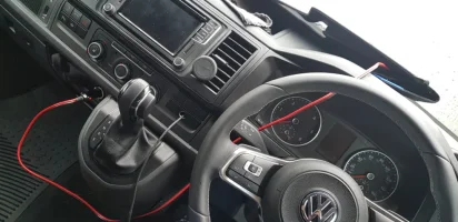

The 50w folding dash panel I have that plugs into the dash socket might help you here? .... Most of the year except winter.
Thanks for the good advice @Dellmassive.
It is unusual for the vehicle to sit and not be used, but you're right about the Ablemail being the best solution.
Do you use any regulation for the output of your 50W panel into dash socket?
oh yes . . . 100% need a solar regulator.

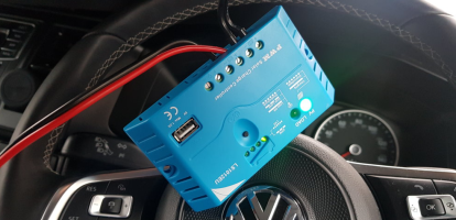

have a look here what i done.
50W folding panel with PWM controller, then fitted a 12v plug.
View attachment 153622View attachment 153623

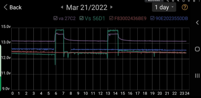

i use two BM2 units on the van.
one on starter,
one on leisure battery.
them use the BM3 APP to see both together on the same plot / screen.
the BM3 APP allows 4x simultaneous BM2 units to be viewed at once.
