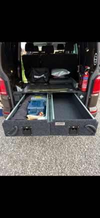

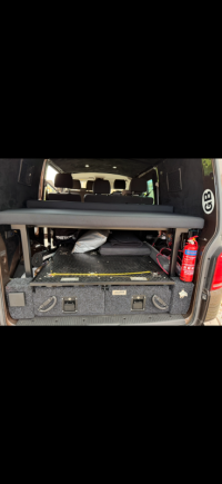

Hi
This is what I use you’re welcome to
have a look but I’m back at work tmrw til Sunday
They’re for sale but you can take measurements before they go
Bob
I have a @VAN-KING system in my LBB Shuttle. The rear (3rd row) of seats are removed and the middle row remain in use, no need to fold them down to use the bed, but it does make it more convenient. I'm just over 6' and the bed is plenty long enough. I usually remove one seat for the fridge and fold the others forwards. If you remove them the is lots of free floor space for getting dressed etc.
In normal set-up there is enough room behind the 2nd row seats for my long MTB with wheels on (I use a Bike Stow 4-bike carrier)
The VK frame is 25mm bow with U-channel to side the bed boards into rather than angle section. There are 4x removable cross braces.
