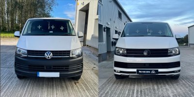

Hi there, yeah it was a startline before it was converted I think the grills were around £250 on van style, thanks for your kind comments:) here’s before and after with my lockdown project on the back
