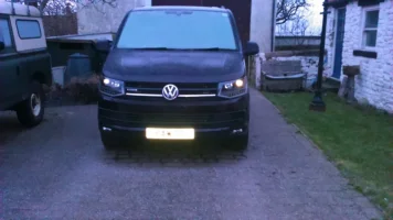

For anyone interested in the Van Tech unit, here is a picture of the fit from the front. It's as good as the original.

@Mooncat They look good, the LED indicators don't look half as garish as the advert pictures! :thumbsup:
How's the light output?

It was a bit frosty and dull when I took this - the lights are not on, that is the reflection from the flash. The indicators flash at the correct speed and look much better than I expected. Regarding brightness, I've been cheating with my H4s and had a set of HIDs fitted (not the cheap ebay ones but a proper set designed for reflectors) and had been waiting for a proper alternative so that I didn't have to drive an illegal vehicle so that I could see where I was going. I've only done a very short run with these (1/4 mile); on dipped beam, the brightness of these units is not a patch on the HIDs and I need to do some comparisons with other halogen equipped vehicles before passing judgement. On high beam however, they are better than the HIDs were (the H4 HID units designed for reflectors are shielded to prevent glare and this compromises the high beam)
One issue I do have is that I would set dipped beam slightly higher than these units go although out of the box, both units aligned perfectly with each other. I'm going to take the rear caps off and see if I've missed any form of adjustment however the instructions say it is all done on the motors. Unplugging the units, changing the level setting in the vehicle and refitting after ignition off doesn't work either. As I said in an earlier post, I think there is a level sensor inside the unit. I have a bore-scope for my phone and will have a look inside.
