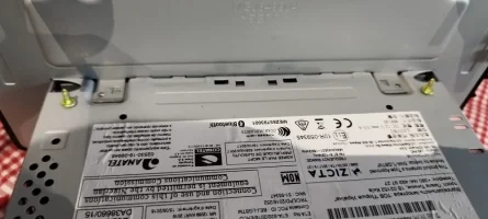

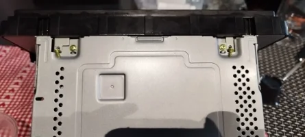

The unit consists of a base and screen, connected by four screws

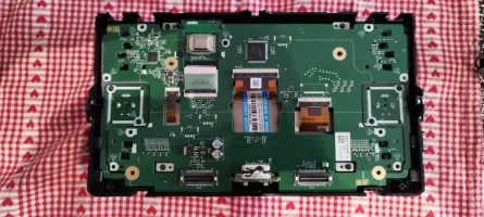

Undo the four small black and two brass finish screws and remove the screen back plate.

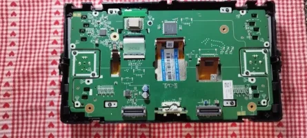

Remove the eight small black screws around the periphery of the board (2 in each corner), do not remove the two screws which secure each control knob.
Remove the four screws which retain the screen clamp brackets, these are visible through the pcb.
Release the three clamps which secure the orange ribbon cables to the pcb by levering the clamp bar upward with a small pry tool.
Ease the pcb away from the top of the case and slide the damaged display out, along with the two clamp plates and insulation rubber strips.
