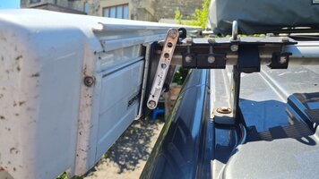

Hi …I’m using the Thule hideaway (3200 ) roof adapter on my roof bars fitted to the trailer…In the Uk it’s sold as the bracket for the 3200 model awning but I’ve seen on the American website it’s used for other awning applications…all using the roof rail system with T bolts….the picture shows one fitting idea but the kit as many different attachments
FCF92AF8-8C25-4BB8-8233-696FD4CCC4CF.jpegBE6D4810-418D-4CEE-B9DC-BCE4721BCCD6.png70D9393B-F6C0-41ED-B298-F687AB6FE318.png

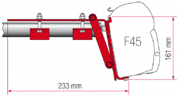

I had a similar quandary about fitting my Fiamma F45S.
After much research and having looked at Fiamma and Thule solutions amongst others, I went with the solution shown below, the Fiamma 98655-770.
Fiamma head office in Italy said that it would not work... but it does. The brackets are wider than they say that they are and do fit over my VanGuard UltiBars.
Very pleased with the result. No holes in the van and mounted at a sensible height.
Fiamma 98655-770 fiamma-f45-awning-adapter-kit-kit-roof-rail-compass-7928-p[ekm]365x195[ekm].png

When I was researching, I came to the conclusion that the Thule 307912 and the Fiamma 98655-310 were essentially the same brackets.
Another option is the Thule 301925
