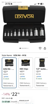

This is a set you need, comes in very handy on all VW as all seatbelts, door striker bolts etc will be M10-M12
Torx bit. Not sure of the size but you can get a set of keys for less than a tenner from screwfix
Lexivon heads are great. Used my splines yesterday to remove all my lashing points and bolts ready for CNC timber floor battens to be glued down and then floor insulation.
Worth getting a set if you are going to be doing any work on a VW/Audi, as they are very common on these cars.
