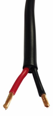

Here is the switch I bought:
and the connector clips (I bought the blue version for the cable I used)
and the cable I bought
As long as you can solder the switch then it was a simple installation
