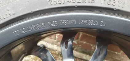

I Have a SWB T32 Sportline. Original wheels have specs stamped inside and states 860KG Max
