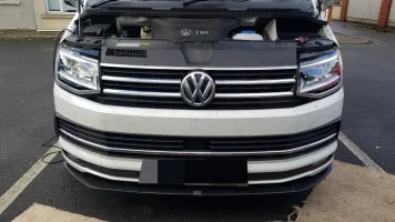

So we have just had the h4 units replaced with Genuine VW Replacement LED Headlight Units and what a difference! Thank you to Paul and to Jamie who fittted them at Retrofit, Plymouth. Retrofit South West
Its not a cheap upgrade, but we can now see at night. I really shows how bad they were before, even with the Philips upgraded bulbs.
Also replaced the front fogs with led so that they are all the same colour.

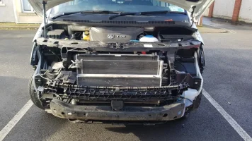

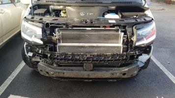

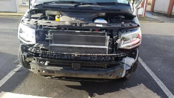

Some basic mechanical and electrical knowledge/skills plus VCDS cable/software is enough.
I have done the whole retrofit(including lights range control/levelling)on my T6 myself.
Disregarding the cost of my labour it cost me approximately £1400 minus £200(I sold my old twin H7 lamps).
I bought all components individually, no DIY kits.
Everything brand new and genuine except range control module and its plug. I got these second hand.
Anybody can do LED retrofit on T6.
Some basic mechanical and electrical knowledge/skills plus VCDS cable & software is enough.
Everything brand new and genuine except range control module. I got it second hand.
Obviously it was a learning experience but as a rough guide how many hours do you think you put into it?
Good work btw. :thumbsup:
Yes, it was learning experience.
It was my first time doing any work on T6 and first time doing external lights retrofit.
Installation of new lights and wiring between them and BCM took me exactly 6 hours.
And then BCM coding took me 3 hours cause I had to figure it out myself, otherwise it is 5 minutes work.
