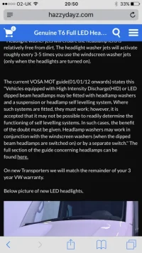

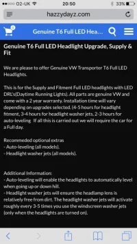

View attachment 10456 View attachment 10455 This is from hazy days I understand this as recommendations not essentials

MOT does NOT check or have the same rules as construction and use! Nor does it superceed it.. The c & u is the daddy of the regs, and the one you HAVE to SATISFY by LAW to use the vehicle on the road!
See the rest of the thread where the stuff is shown here and read up... You CANNOT sidestep c & u with MOT.. Won't stand up in court and you will be crucified!

It is up to @Pauly to make SURE of the rules and regs applicable to his kit.. I have put forward a possible reason for the headlights washer system, WITHOUT saying its needed, as Pauly needs to quote a documented reliable and authority for his due diligence, not the opinions here!
Self leveling I have proved is required, and quoted a source to him to check on and satisfy himself, rather than breach c & u by fitting a manual system!
