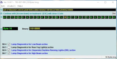

I noticed the voltage was low on the logs, 11.6V on Friday and 12.2V today, but as soon as the engine is on it kicks up to 13V. I thought I'd have a look at the voltage as the new CTEK I had fitted with a 2nd battery, might be dragging the voltage down (I've seen comments of this on the forum somewhere).
I had another go at clearing the faults, and can clear them now but the bulb out light just comes straight back on as soon as I put the headlights on, but I've a shorter list now, Ross-Tech diagnosis isn't at all helpful, so still looking for ideas for what to have a look at next

It's a retrofit, but fortunately @Pauly has just pointed out to me a code change that we didn't make when it was first set up. I still had Low Beam Monitoring still turned on, which I don't need with the LEDs. So just turned that off and its sorted.
It's been fine for 18 months, so I can only assume that there's a slight change in voltage level due to the CTEK and 2nd Battery and that's triggered the change in behavior.
Byte 16, after the coding as shown:
