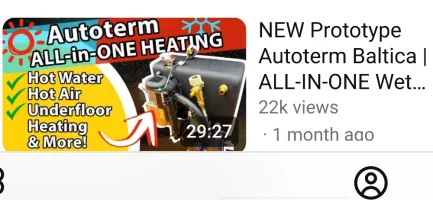

Autoterm are looking at marketing an all in one option, to heat air and coolant/ water, etc IMG_7104.pngsaw it on YouTube, might be an option

That's very interesting Green Giant, thank you. It has similarities to using a Surejust twin-coil calorifier, (one coil for engine coolant and one for a diesel heater eg Webasto) in which the hot water could double as the hot coolant in the Baltica if hot air etc were needed. Surejust aren't cheap so it'll be interesting to see the price of the Baltica in due course.
