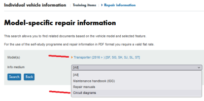

I have used VW erWin
Just register - and for a very reasonable fee - can download the PDF's.
Prepare yourself a bit (even without registering or logging in) to see how the documents are organized - e.g.
Full T6.1 circuit/wiring diagrams - under Repair information (see below)​
or just vehicle specific - under Vehicle-specific (much slower) as you download sections individually.
x
x
x
By tapping "i" you get even a glimpse into contents listing - for free​
Anyways - should be pretty straightforward to navigate.
1 hour should be more than enough to download everything about T6.1.
1 day is more than enough to download ALL the documents about ALL VW models :whistle:
