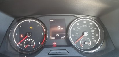

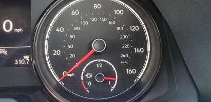

Twice now we have filled our T6.1 up and both times left it until the diesel pump clicked off. When I jumped in I expected to see the gauge reading full, but it's always showing one black line off of the top one.
Is this normal or is there something I need to have looked at?
Do you think the diesel is there and the gauge is not showing it or is the gauge correct and the pump has clicked off too soon?

Did you manage to dig this out?. Mines the same, you fill it up to max and as soon as you drive off it starts dropping like the original pic. I know it's meant to go down haha. Only ever managed to get 62l in even with no range.
Yes i did find it and basically it was incorrect software setting from the factory regards 70/80l tanks, this would cause the fuel gauge to never show full
