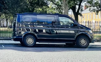

Suspension sagging at the rear. What can I do?
I’ve taken some photos from underneath if these help with a diagnosis?
Fitting a spacer above those springs would increase the rear ride height, but it'll do nothing to improve the ride quality. That spring clearly isn't up to the job of carrying the weight of the camper and really needs replacing. The crashy ride is due to the lack of movement available until the spring is completely solid and bumps are just transmitted straight through to you. It would be interesting to see what the front looks like.
Unfortunately, you're going to need to replace what's on there with something more suitable. If you like the current front ride height, then you'll need a set of quality coilover suspension, but you're looking in the region of £950 plus fitting. These can be adjusted to ensure the correct rake angle etc. Alternatively, you could have some good quality lowering springs fitted that can be correctly specified to ensure they cope with the weight in the back. To ensure the best possible ride quality, it's a good idea to fit some upgraded shocks too, like the quality Koni options that are available. This would lead to a drop of approximately 40mm from standard ride height, so higher than the van is now, but would be a huge improvement in ride quality.

Everything that’s been said makes sense, and I’m not entirely surprised. I spent a lot of money on the van and intend having it for a number of years, so I may just have to take the expensive pain of getting this sorted out!

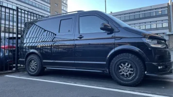

Internal mods done at last and here is the result. Your thoughts on the remedy most appreciated. Easy fix but also ride quality fix
The front is approx 20 mm down and the rear 40 mm , we need to get them level

Depends on whether you do proper shocks to get the ride , comfort and Handling better , then its no more work to drop the front of course

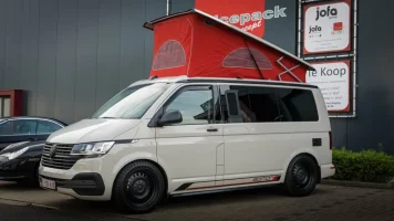

Since having the rock n roll bed fitted to the front of my campervan it now sits 60mm higher at the front than the back. The ride is also very hard. I'm hoping to find a suspension expert in Glasgow or West central Scotland who could even up the front and back by dropping the front down so that the van sits level and hopefully to make the drive softer. Presently, I feel (and hear) every single little bump in the road.
I know there are options/ for spring coil-overs etc but I have zero experience/knowledge on this subject.
Any advice would be gratefully received.
