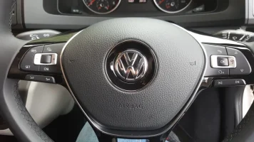

    You can also use the res and set buttons to adjust the speed by 1 mph at a time.

    seen a wheel i like 2nd hand
    but
    on the left side controls under the acc chrome button mine says CNL
    on the one i want to buy it says MODE with a little speedo icon ??
    whats the difference ??

    Mmmm not sure about that, i have CNL = cancel. i dont have ACC on my combi :(. Mode button maybe does something different ??

    yeh its just that mode button were mine says CNL thats doing my head in

    Whats the difference with CNL & mode then guys ? also ACC ?

    CNL = Cancel
    ACC = Adaptive cruse control
    Mode = Driving/sport/eco/steering i think :unsure:

    ok, i took the battery off and changed the wheel for a very similar one with paddles
    now nothing works and loads of errors came on the dash
    do i need vag-com to set it all backup ?
    or shall i change all the buttons and chrome strip in one but how does it all come off ?

    You're the guinea pig @T6 dork so i have no idea why its not working, @RattyMcClelland is on the case too. You say similar why not he same ??

    Stupid question but i assume you plugged the connectors in :rolleyes:
    Were they the same as the ones from the old wheel ?
