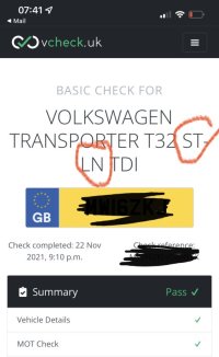

More options - vcheck.co.uk do a basic check based on reg plate which, in the case of my van at least, shows the basic model info. It cost £2.99 and was instant. Startline shows up as ‘ST-LN’. Here’s mine below.
