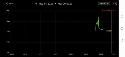

I've attached a BM2 monitor to the battery and fully charged it from the mains yesterday evening. It was at 98% at about 8pm and dropped to about 50% within a couple of hours.
Thats a very quick drop, looks like the voltage is dropping to low 12s as soon as you stop charging it in which cause you probably have a faulty battery

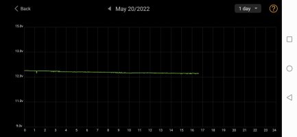

Is there more than likely a drain, as the battery is at 38% and has been for a while? Voltage hasn't dropped much over the past few hours either.
No evidence of significant drain there, doesn't rule it out completely though - just that it's likely not happening right now. Maybe start the van up and check that the voltage goes high from the alternator. Also check victron DC-DC status before/after engine starting to check nothing odd there.

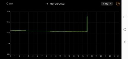

The Victron DC-DC was off before I started the van, then went to absorbtion charge, before turning back off.
Just to add, I was having issues with the starter battery draining during a period where my old Victron DC-DC Charger wasn't working at all and also, once I had disconnected it completely. The current one is a replacement.
Both the alternator and the Victron DC-DC seem to be behaving as expected from that brief test, and nothing problematic that I can see on the negative terminal.
