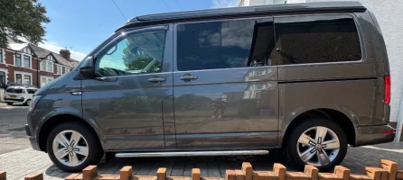

Will these front springs fit my 2016 T6 T32 Kombi.
I want the van back to factory ride height.
They are from a T6.1 (T32) but I have now removed the rubber bonded rubber ‘seat’ from them hoping they fit.
They seem to look shorter than T6 spec? Looks like one less coil to me . Will the van sit Lower than it should with them ?

Cheers man , with that I think I’m going to go with them ,they’re 20mm shorter apparently. That will hardly be noticeable, if at all? My van started out as a kombi and is now a full weighty camper so maybe this could help a smidge to level things out when its fully loaded?
It’s booked in Friday. I’ll post the results. 👍🏻
They will fit but the T6.1 spring is a good 20 mm shorter , so the van will be 20 mm lower . What you could have done is leave the sound isolator on and we could have given you 2 low mileage T6.1 dampers and it would have been spot on . same height
Thanks for your knowledge.. I should have!..So if I go ahead and use them with the T32 OE rear springs that are also going on as well it will just sit 20mm ‘ish’ lower up front.
I was going to fit 13mm rear spacers from Transporter HQ that I have. Do you think leave them off now to avoid the nose down Wacky Racer look. 😂
Yes dont fit the spacers it might level up the chassis a bit more
