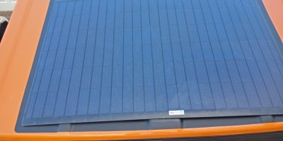

I have just finished fitting the 200w Photonic Universe reverse junction box panel. With the Renogy 50w DC to DC charger and MPPT controller performing all it’s switching duties the panel is performing great so far. Not been able to test it under load yet but the integrity of the Sikaflexed attachment was tested up to 80mph on Saturday with no problems. it’s very flat on the pop top. No more than 3mm of height. So for anyone with headroom issues, like me, it’s perfect.

@Qnapper where does the cable come out on that panel? Is it in the middle of the short side at the back of the panel? I'm looking for an upgrade to my 100W panel that has a cable exit on the rear, It needs to have a voc of less than 32v to work with my redarc DC/DC charger and that NDS panel looks like a viable option so long as the exit suits where I already have a hole.

Hi, it's in the middle rear of panel.

Thanks @Qnapper,It looks similar to my existing 100W one, just mine is on the long side and fits nicely at the rear of the roof.
If I replace it with a 200W one I'll have to change the vinyl to suit.
I think it will fit fine and very close to what you have fitted size wise. The différance from 100watts is great, at the weekend I got from 8/12.5amps at midday and topped my battery by 2pm after taking loads out using the inverter for lunch.
The panel measurements Length x Width x Height: 1488 x 673 x 4 mm
