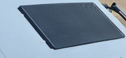

I've just had my flexi panel replaced due to it failing after about 3 years. I was also told it was probably due to lack of air flow underneath and it over heating. They couldn't get the old one off without damaging the roof, so have installed the new one over the top. The place I had it done did a really good job. I did think about a rigid one that would last longer but didn't want to add the extra height, even though I know this one might need replacing again in a few years. 20260428_171201.webp
