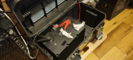

I'll also be taking 3x of my lithium battery boxes that can be used to recharge the units via 12v if the solar isn't good enough.

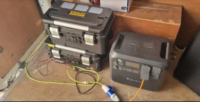

no issues though as i plugged in one of the 100ah lifepo4 battery boxes ( i took 3 ) , that dumped its stored energy in to the AC200max - up to about 45%.

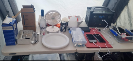

We’ve just done 4 days at Le Mans and the Ecoflow river pro and 110w panel performed brilliantly, it ran the beer fridge, charged half the phones on site and the fairy lights. The lowest it dropped to was 26% charge, i just chucked the panel on the roof and left it to do it’s stuff.
granted it was 28 c and clear skit’s, very happy with it.
i don’t have a thermal cover for the 55l vevor and it and the Ecoflow lived in the amending and it was b#@£dy hot in there in the day

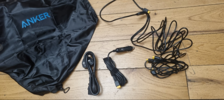

it comes very well packaged . .
which is good as its heavy . .
charge cables and install guide.. .
the dust cover is a very nice addition.
looks like they going for XT60 connectors, - similar to bluetti
out the box its a very good looking power pack,
the rear cover & input setup look very EcoFlow . . . . ?
look at the attention to detail . . . even on the rubber feet ( that you will never see) - nice large textured rubber feet.
plugging in the IEC mains cable its start charging . . . . AT 1000W !!!!!!!!
now thats fast !!!
size wise its similar to the AC200Max - which i wasnt expecting.
it feel very premium in all aspects so far . .

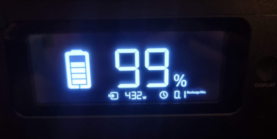

the screen is excellent and has good viewing angles
look its 99% charged already !!!
