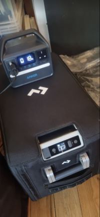

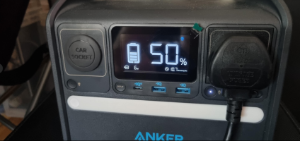

fwiw . . . .
i have a CFX35 and the Anker 521 to hand . . .
so ill do a quick test.
so we have the fridge with some beer in . . .
The Anker 521 . .
its on 66% right now . . .
had the fridge plugged in for an hour or so . .
now its down to temp . .
when the compressor cycles on . . . it draws 50w ish,
when the compressor stops and the unit idles we see 6w ish. . .
at the idle point we see 6w,
with the battery pack at 50% we see the estimated run time as 10.7 hours,
so doubling that for the 100% we could expect 20.2 hours.
this is just a rough test . . .
at some point ill do a full capacity run test . . . but for now lets say its doing to run for 1-2 days. ( depending on usage and ambient temps _)

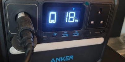

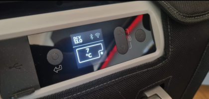

I see you're running it off the 240v output. Out of curiosity I'd be interested if an hour's running off the 12v confirms our theory about its relative inefficiency. I still have no real clue as to why though!
sure. . .
running on 12v socket. ( Regulated on the Anker 521 )
fridge shows 13.0v . . .
with the compressor running we see 53w out..

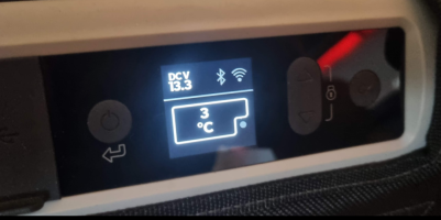

a few mins latter the fridge is down to temp. . . . 3degc
the compressor switches off . . .
the voltage is shown as 13.3v (off load)
the Watt draw shows 0w when on idle . .
so very similar results to the 240v test.
240vac - 50/6w
12vdc - 53/0w
next test would be a full discharge test on 12v and 240v to see how long the fridge would run.

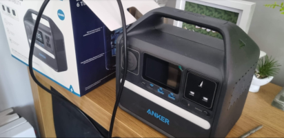

View attachment 157160View attachment 157162View attachment 157161
heres mine,
unboxing and testing coming up soon . . .

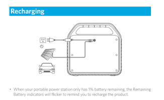

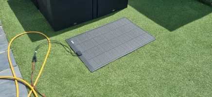

ANKER 521 - Solar charging . .
Suns out so its solar time . . .
Here is the Anker 521 . . . .
I've coneected it up to a LENSUN 150W panel . . .
The Anker spec shows:
DC Input 11-28v @ 5.5A / 65W max.
My solar panel VOC is about 19v so thats within the volts range.
so the Anker will just draw as much as it can from the panel . .
in this case 65W max.
so the Anker display shows 61W and 3.4hr recharge time.
Happy Dayz. . . .

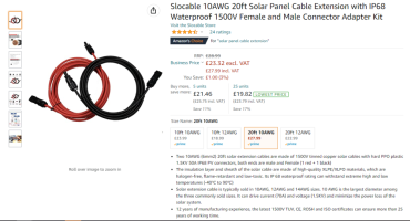

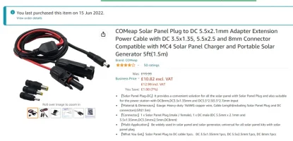

i needed an adapter cable, for the solar MC4 to DC 8mm input connector.
so i grabbed on of these . . . . .
i also used a MC4 extension cable - to keep the solar panel in the sun and the Anker battery pack in the shade . . .
example here:
( i made up my own)

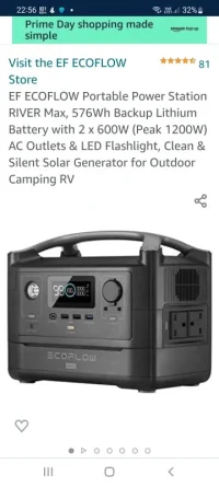

@Dellmassive thanks for this helpful thread.
I‘m considering an Ecoflow River Max instead of a leisure battery.
Intending to run an ignition live from the middle row of the fuse box to charge it.
Then will run some wire to the CBE 13a and USB sockets in the side panels.
Do you think the 60 degree c max temp is realistic for it to live in the van - insulated but not sure what internal temp is likely to be on a hot UK day.
Also, I can see some grilles around the device - do I need to consider leaving some of these open to the interior of the van via some grilles/mesh in the ply rather than completely boxing it in?
The 12v charge side is about 8A.. so that should work to charge from IGN.
The side vents are for cooling... Mainly for the fast mains charging and inverter use.
If you was fitting it in the van you want to give it maximum ventilation.
Lithium batterys don't like getting hot... So I'd look at keeping it as cool as possible.... Ideally below 30-40degC max.
I think you main issue will be power capacity... The EF river Max has 576wh of power.
That's half a standard 100ah lithium battery (1200wh)....
Then once that's used up..
Plus a slow recharge rate of 8A, 70w while the engine is running means you need to have the engine running for 8hours for a full recharge.
Unless of course you plan to take it indoors for a mains fast charge.
Keep us posted with your setup.

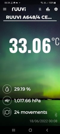

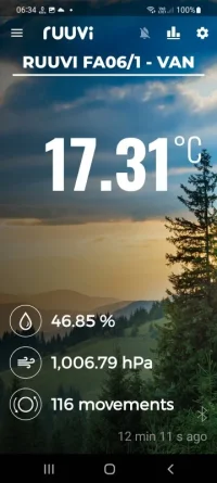

Any idea how hot the inside of a black insulated/lined van would get if the outside temp hit the recent high of 30degrees like it did here in Essex the other day?
Not sure on your temps...
But but mine reached 37.7c the other day looking at temp data. (Silver panel van, no insulation)
Sensor located in seat base next to lithium battery.
These are great little boxes..
So I'd say give it a go... If for any reason it didn't work out then you can always fit a proper leisure battery and use the mobile box along side it.
Other temp data.
Screenshot_20220625-063422_Ruuvi Station.jpgScreenshot_20220625-063411_Ruuvi Station.jpg
