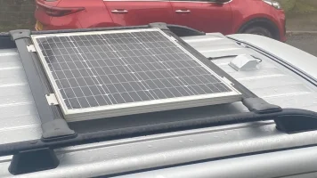

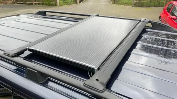

When I was considering fitting a PV panel to my camper, I decided I wanted the low weight of a flexible panel but didn’t want to stick it directly to the pop-top and I certainly didn’t want to the weight of a rigid panel. The solution therefore seemed to be a hybrid approach of fitting a sandwich of a Renogy 200W flexible panel bonded to a twinwall polycarbonate sheet supported about 10mm above the roof by a frame of alloy channel and 3030 profile attached to longitudinal roof bars. Overall the height has only increased marginally and now has a total overall height of 2.030 m. This is the result…
