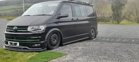

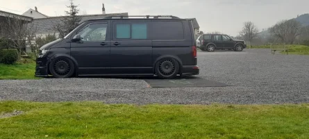

Front tyre not flat it’s the way it goes when air out as wheel gets pulled in
I've heard of people modifying arch liners but not sure exactly what they do.
Any option to raise it 5-10mm and see if it helps?
What size tyres do you have fitted?

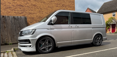

What sizes are people running on the 20" wheel? My van came with 275/40 R20, but was thinking of going to 245 /40 R20, or similar... thoughts?
There's loads of info about this floating around the forum... to summarise, there isn't a simple answer. It seems to be one of the biggest nightmares haha!!!
Fronts are 255 35 I have thought about raising it but I want it a touch lower on the front cause I’m a bit of a sucker for a low van

20 x 9J ET45
245/45 R20 103Y Giti Control P10.
I think a 40 profile tyre would have looked better, but seems to be very little choice in brand load rated for the T32.
