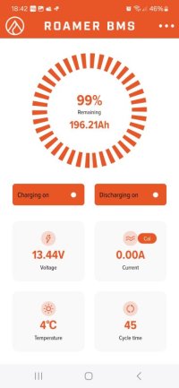

It is a big bugger, according to that pic you've got 414Ah left! Odd though at 100% charge, I would have thought you have the 460Ah battery? More than twice the size of my measley 200Ah! Well, 198Ah now, I've lost 1% after nearly 3 years, most upsetting... the shunt looks a bit/lot out!

414Ah would last a good 6 days though, unless, like my wife, you like to boil a full kettle of water at 2000 watts on the induction hob! Bless...
