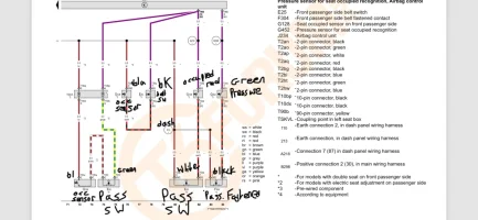

I looked at this recently due to wanting to disconnect all 4 connectors under the seat for a swivel base.
It seems the arm goes off when there is a closed circuit on the system. The 4 connectors are in the double seat base, towards the middle at the bottom.
You could disconnect each connector and put a multimeter in them in turn to isolate the issue.
As far as I can tell, you only need the rhs of the below diagram.
