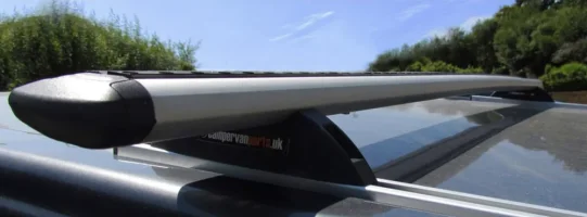

I have the HiLo sport also. I know there is no rebate, and as a result, the rails will stick out. They are however just few millimetres thick, so when you get the cross bars off the van height is barely changed, as in the image below which is from campervanparts.uk. I like a lot their kit, and I will probably get it from them. The thing is that I already have the Thule bars and installation kit from a california, which I think are compatible. I am trying to see if they will sell me the rail as they only offer it as part of the kit. Otherwise I may have to but the whole kit and sell what I already have...

No… still after them. I think I will get the whole kit from campervanparts.uk. I need to figure out if I drill outside the hilo frame or through the actual frame.
The bolts go through the roof skin and are through the centre of the roof lid box section frame that’s around the canvass
I have this campervanparts rack fitted to my roof, if you can fit rails outside the canvas,it would give a wider load space, just make sure where the rails are going to be fitted, and the holes drilled, there is enough clearance to fit the nuts and washes on the underside, so they lay dead flat, just double check the metal fixing plates for rear poptop hinges are clear from the new fixings
